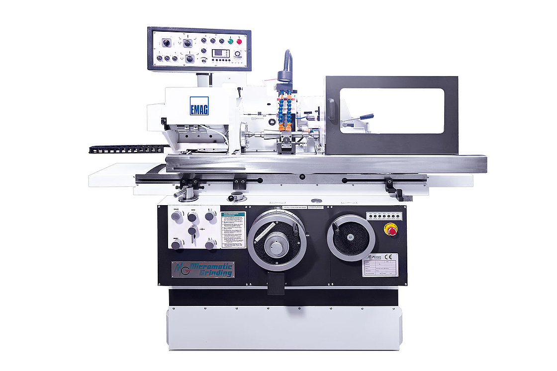

ECO 200 - Compact, Conventional Cylindrical Grinder
The conventional cylindrical grinder ECO 200 delivers EMAG Weiss grinding quality, while minimizing investment costs. This precision cylindrical grinder is targeted to users who do not require a CNC control unit, but still set the highest requirements for machining quality.
ECO 200 - cost-effective, highly accurate precision cylindrical grinder for the smallest workpieces
The ECO 200 is a simple, cost-effective, highly accurate precision cylindrical grinder with a tip width of 400 mm (16 in) and a tip height of 100 mm (4 in). The machine is easy to operate and access, which allows for fast machine tooling. The grinding headstock has a drive rating of 3.7 kW (5 hp) and can hold grinding wheels of up to 350 mm (14 in) in diameter. The workpiece headstock has an MK4 socket and enables continuous speed adjustment up to 500 rpm at a drive rating of 0.75 kW (1 hp). The tailstock has an MK3 socket with a quill stroke of 25 mm (1 in).
An internal grinding device featuring a spindle socket of 80 mm (3 in) in diameter and with a drive rating of 1.1 kW (2 hp) is also available.
Advantages ECO 200
  • Low investment cost
  • Easy operation
  • Easy retooling
  • Simple machine concept
  • Small footprint
  • Highly accurate precision cylindrical grinding
  • EMAG Weiss quality
