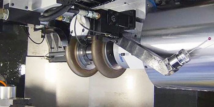

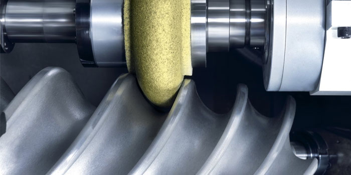

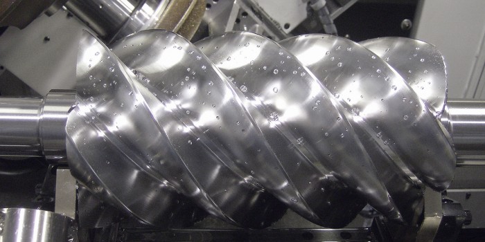

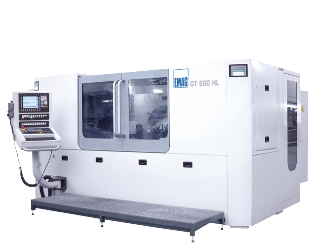

The GT 500 HL is suitable for the manufacture of very large screws and rotors.
Manufacturing of very large screws and rotors
The GT 500 HL screw profile grinding machine is suitable for the manufacture of very large screws and rotors.

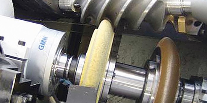

Especially suitable to grind with CBN, the GT 500 HL also facilitates working with dressable ceramic wheels or even combinations of the two.

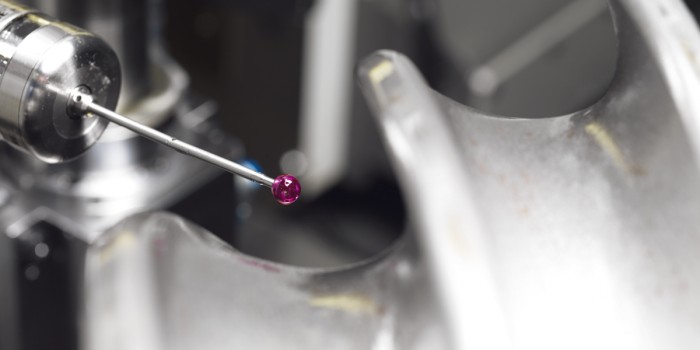

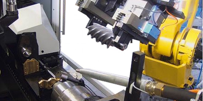

An integrated measuring unit also makes the correction on board. For more efficient handling, you can link the GT 500 HL to an external robot device and connect it directly with an external measuring unit.
Like the GR gear profile grinding machine, the GT 500 HL comes with a rotor-specific software package, developed under real manufacturing conditions.
Advantages GT 500 HL
  • Special machine version for the manufacture of large rotors
  • Extra powerful main spindle for high stock removal
  • Double tool setup for roughing and finishing on one spindle
  • Tried and tested rotor manufacturing software
  • Integrated measuring
  • Connection with measuring unit by means of external PC software for the closed loop manufacturing checking
  • With a single grinding, wheel profiles with a depth of 120mm and width over 200 mm can be grinded
