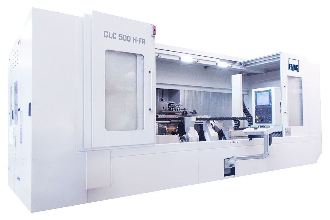

CLC 500 H-FR: Versatile
high-performance profile milling machine for precision rotor machining
The CLC 500 H-FR is a powerful horizontal profile milling machine based on the proven
CLC 500 H gear hobbing machine. Specially designed for heavy-duty machining and precision machining of rotors, rotary pistons and worm-like components, it offers optimum solutions for demanding production tasks.
Machining of rotors, lobes and large worms
The CLC 500 H-FR is an advanced solution for profile milling. It combines precision, performance and flexibility and is ideal for companies that place the highest demands on the quality and efficiency of their manufacturing processes. The CLC 500 H-FR can machine different types of workpieces, offering a versatile and efficient solution for modern manufacturing requirements.
Robust mechanical engineering
  • Sturdy design for maximum precision and reliability
  • Flat guides for increased rigidity
  • Ground and hand-scraped guideways in radial and axial direction
  • Optimized for heavy-duty machining and high accuracy
Maximum milling performance
  • Powerful profile milling head
  • HSK interface for high stability
  • Counter bearing with milling arbor holder for various milling arbor sizes
  • Integrated measuring probe for measuring the root diameter
  • Use of carbide insert milling cutters for high chip capacity
  • Compact design enables large spiral angles
  • Machining options: oil, emulsion or dry operation with carbide tools
  • Large spiral angles thanks to compact milling head
Flexible milling technology
  • Can be used in oil, emulsion or dry operation
  • Option for bed flushing with emulsion for dry milling machines
  • Combination of dry and wet operation for optimum thermal stability and reduced tool wear
High-performance table drive
  • Direct drive with high torque
  • Designed for extreme chip capacities
Automation solutions
  • Gantry automation including infeed and outfeed conveyors
  • Robot cells including infeed and outfeed conveyors
  • Enables unmanned production and minimizes non-productive times
Areas of application
  • Versatile machining of rotors, rotary pistons and screw-like components
  • Suitable for single part and batch production
Integrable options
  • Measuring device for measurements directly on the machine
  • Further customer-specific adaptations possible on request
이점 CLC 500 H-FR
  • Maximum precision in the machining of complex profiles
  • Short cycle times thanks to carbide tools
  • Machine for heavy-duty machining thanks to stable machine concept, high chip capacity for efficient production
  • Flexibility thanks to various processing options and large spiral angles
  • Heavy and rigid machine - robust construction for long-term reliability
  • Steady rests on NC slides
  • Automatic loading and unloading possible - Extensive automation variants available
