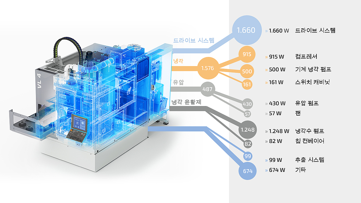

We pay particular attention to optimizing the energy consumption of our machines. We therefore analyze energy consumption and use energy flow diagrams to analyze where and how electrical power is called up. In this way, we were able to determine that a large part of the energy consumption is caused by ancillary units such as cooling and hydraulics, and that only 10% of the total energy flows into the direct cutting process, while 90% can be considered "unproductive". Nevertheless, this "unproductive" 90 % is necessary for the operation of the machine. EMAG sees considerable potential for improvement and optimization here, without compromising the performance of the machine. An energy flow measurement is therefore the first step in the revision of existing machines; on this basis, the potential for increasing efficiency is evaluated.

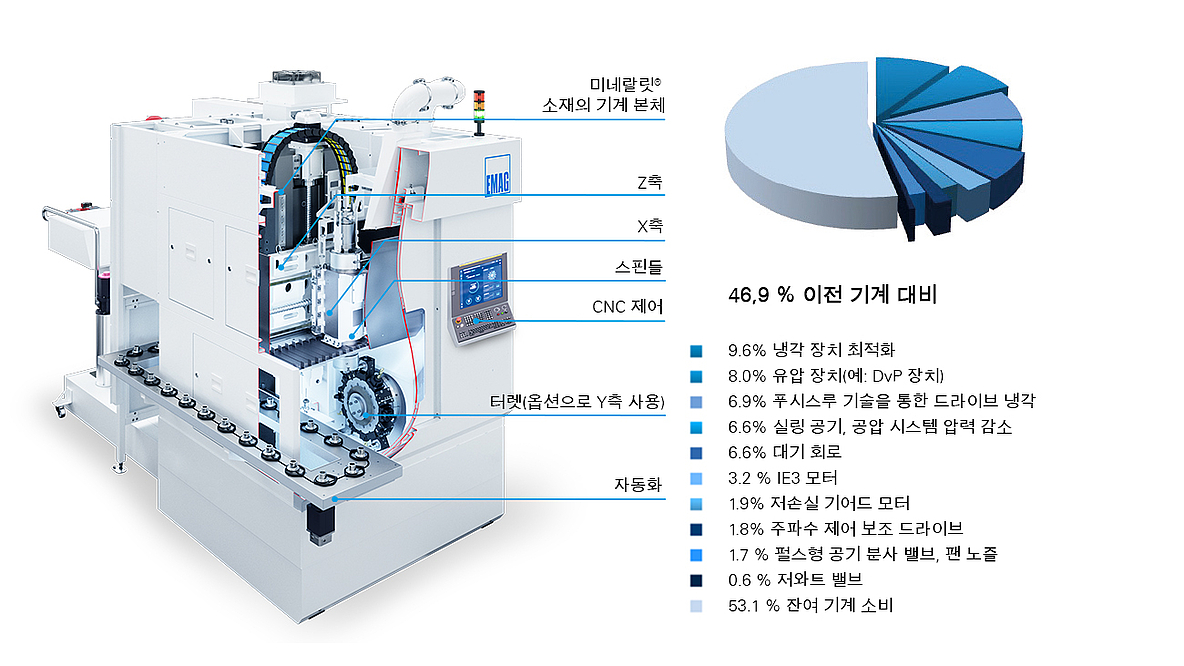

EMAG machines are continuously developed with regard to their energy consumption. EMAG follows a fixed release cycle in which innovations are incorporated into the standard. This is evident, for example, in the areas of hydraulics and cooling units, where the latest models are always to be used wherever possible in order to ensure even better energy efficiency. In addition, lightweight construction is playing an increasingly important role by reducing the mass of moving parts without compromising on rigidity or dynamic behavior.

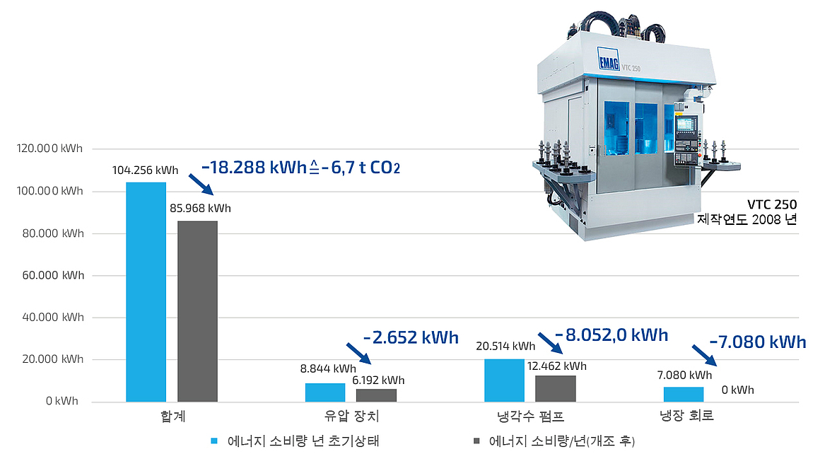

Existing machines also benefit from this. For example, EMAG carried out an energy efficiency retrofit on a lathe from 2008, which enabled energy savings of over 18,000 Kwh per year. This is equivalent to the energy consumption of more than two single-family homes. The retrofit took only one and a half days and the machine was immediately ready for use again. The payback period for such a project is about two and a half years with government subsidies and about three and a half years without subsidies.
