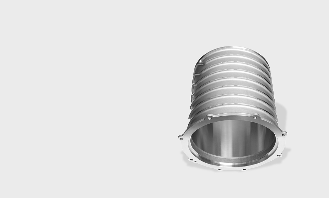

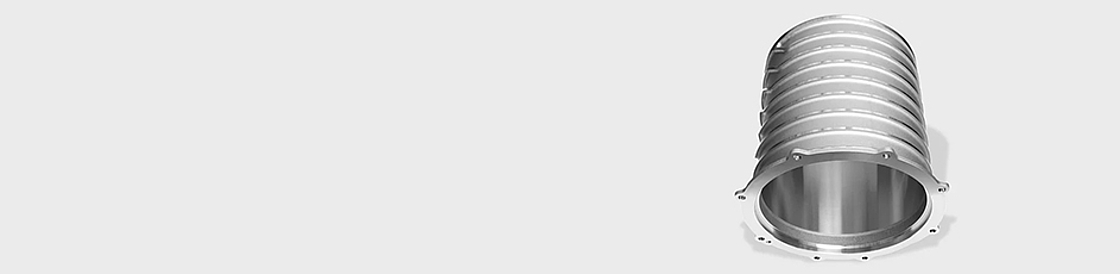

The completed part
The walls of the completed stator housing are very thin, only 4 mm – with tolerances of only 0.016 to 0.25 mm and very accurate roundness. At the same time, there are many bore holes and grooves, and the geometry is not rotationally symmetric.
