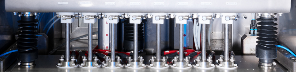

EMAG ECM uses a clever technology concept that has been specially developed for rifling. The quality-determining technology is located in the rifling module, which is inserted into the PI ECM machine depending on the requirements. According to the production volume, a double or eight-fold module is used so that two or eight barrels can be machined simultaneously.

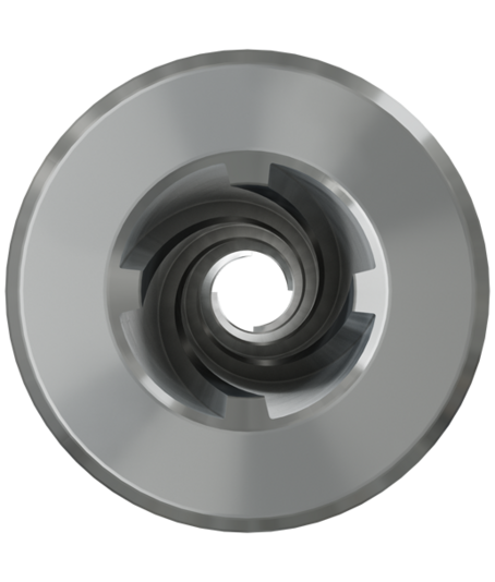

With ECM rifling, the tool cathode generates the desired internal geometry of the barrel with high precision. A variety of different geometries are possible, for example “polygonal”, “progressive” or “standard rifling”. It is faster than the frequently used hammering process and has lower investment costs.
