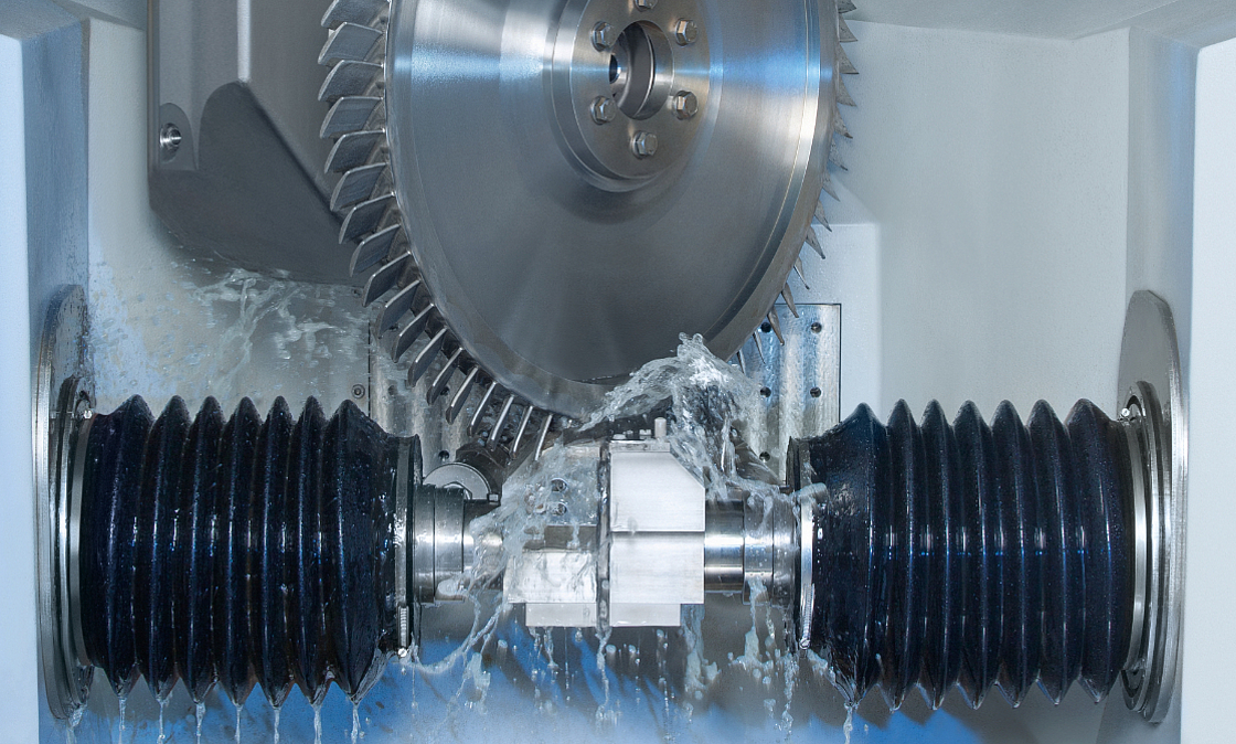

Electro-chemical machining is based on the principle of electrolysis.
The tool, i.e. the cathode, is connected to a direct voltage source with the workpiece acting as the anode. A charge exchange takes place between the cathode and the anode in an aqueous electrolyte solution which targets specific areas of the workpiece. This can be used to create contours, ring ducts, grooves or bell hollows with no contact but very high precision. The removed material is precipitated from the electrolyte solution in the form of metal hydroxide. The machining can be carried out regardless of the structural condition of the metal and both soft and hard materials, including exotic metals, can be machined.
The components are subjected to neither thermal nor mechanical stresses.
