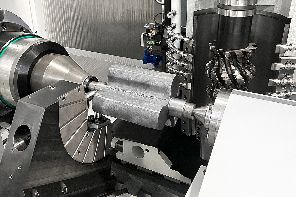

CLC 500 H-FR: Versatile
high-performance profile milling machine for precision rotor machining
The CLC 500 H-FR is a powerful horizontal profile milling machine based on the proven
CLC 500 H gear hobbing machine. Specially designed for heavy-duty machining and precision machining of rotors, rotary pistons and worm-like components, it offers optimum solutions for demanding production tasks.

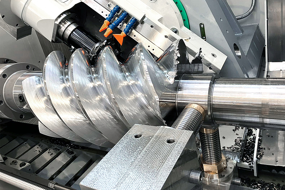

Machining of rotors, lobes and large worms
The CLC 500 H-FR is an advanced solution for profile milling. It combines precision, performance and flexibility and is ideal for companies that place the highest demands on the quality and efficiency of their manufacturing processes. The CLC 500 H-FR can machine different types of workpieces, offering a versatile and efficient solution for modern manufacturing requirements.
Robust mechanical engineering
  • Sturdy design for maximum precision and reliability
  • Flat guides for increased rigidity
  • Ground and hand-scraped guideways in radial and axial direction
  • Optimized for heavy-duty machining and high accuracy
Maximum milling performance
  • Powerful profile milling head
  • HSK interface for high stability
  • Counter bearing with milling arbor holder for various milling arbor sizes
  • Integrated measuring probe for measuring the root diameter
  • Use of carbide insert milling cutters for high chip capacity
  • Compact design enables large spiral angles
  • Machining options: oil, emulsion or dry operation with carbide tools
  • Large spiral angles thanks to compact milling head

  • Versatile machining of rotors, rotary pistons and screw-like components
