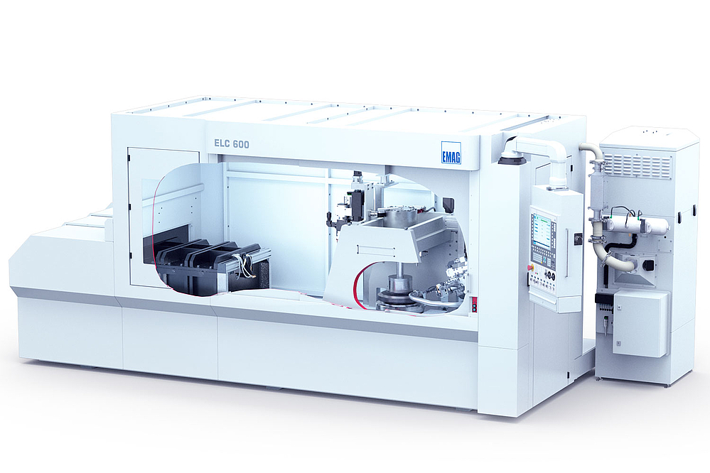

ELC 600 Laser Welding Machine for the Commercial Vehicle Industry
With the ELC 600, EMAG LaserTec presents a system for laser welding of components up to 600 mm in diameter and is therefore ideal for components from the commercial vehicle segment. Sample differential housing for trucks: These components weigh up to 130 kilograms and have a diameter of up to 600 millimeters and are already being manufactured on the machine presented here.
Production Solution for Large Components
In the ELC 600, the components are transported to the laser welding position in machine slides with an integral chuck and welded at high speeds, thanks to the precise axes and high-precision beam control system. Even cast steel and/or case-hardened steel connections with great depth are feasible on this machine. These are ideal conditions for using the ELC 600 laser welding machine in the commercial vehicle segment.
