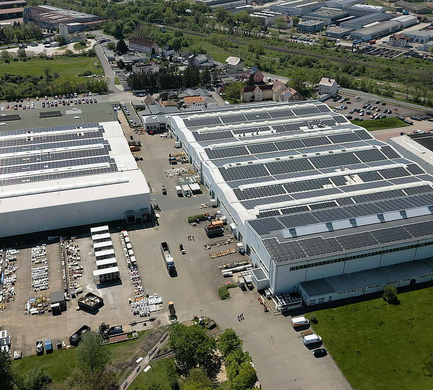

![Photovoltaic system on the hall roofs of EMAG Zerbst Maschinenfabrik The photovoltaic system of EMAG Zerbst Maschinenfabrik, installed on the hall roofs, which generated an impressive 2.1 megawatt hours of electricity in 2022.](https://cdn.emag.com/fileadmin/_processed_/3/4/csm_03_ThomasScholz_71d52d744a.jpg)
Solar energy
Another important component of EMAG Zerbst Maschinenfabrik's commitment to energy efficiency is the strategic use of photovoltaics. In a world that is increasingly turning away from fossil fuels and looking for sustainable energy sources, the company has recognized the importance of regenerative energy generation and invested in the use of solar energy.
A photovoltaic system was installed on the hall roofs in four construction phases. With an output of 2.6 MWp, the plant is capable of generating a considerable amount of clean energy. In 2023, the system produced an impressive 2.4 gigawatt hours of electricity. Of this, 1.4 gigawatt hours were consumed directly within the company, further increasing independence from external electricity suppliers and reducing emissions.
Investing in solar energy not only demonstrates EMAG Zerbst's commitment to environmental protection, but is also a far-sighted business decision. Given the global pressure to reduce carbon dioxide emissions and meet the goals of the Paris Agreement, the importance of renewable energies will continue to grow. Companies that invest in technologies such as solar energy now are positioning themselves not only as pioneers in sustainability, but also as viable businesses in an increasingly low-carbon economy.
