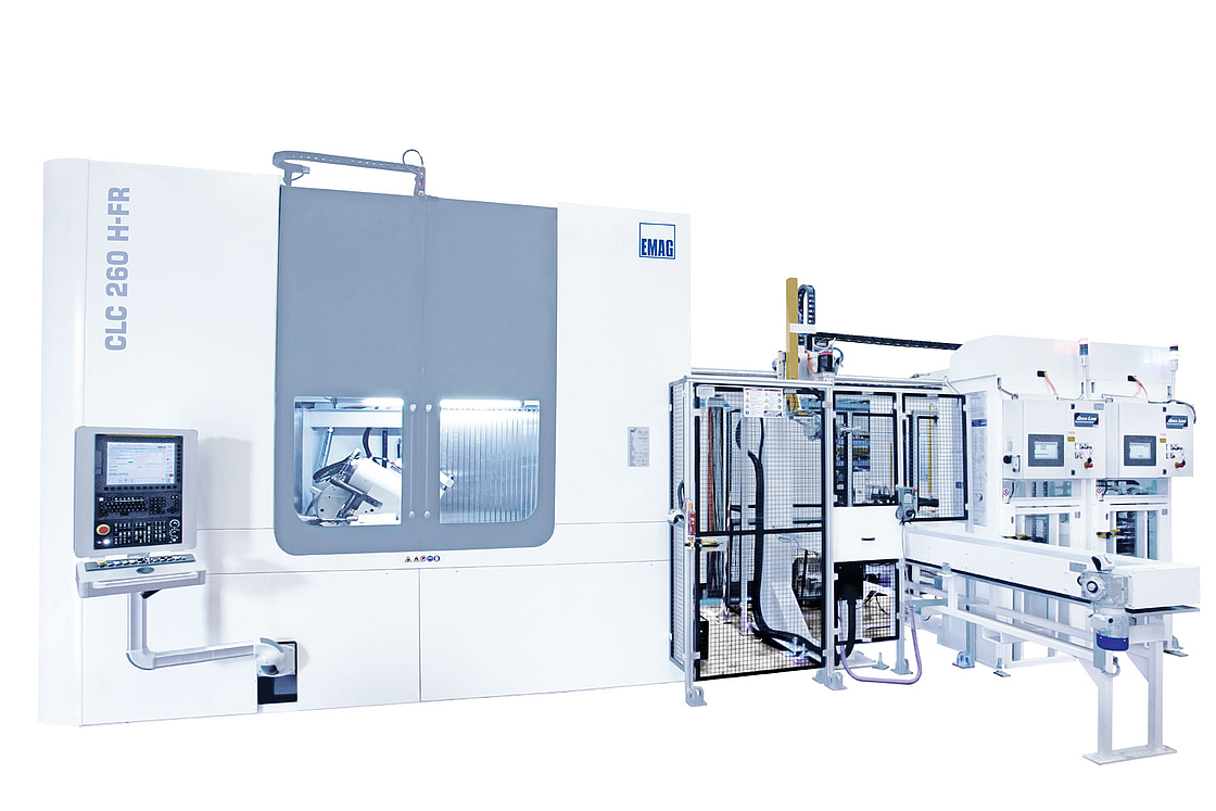

CLC 260 H-FR: Precision profile milling machine for worm machining
The CLC 260 H-FR is a horizontal profile milling machine specializing in the high-precision machining of worms for worm gears and hydraulic spindle pumps. This machine combines efficiency, precision and versatility in a robust system.
Machining of worms and long worm shafts with tooth profiles
Efficient CLC 260 H-FR profile milling machine: From single part to series production
The CLC 260 H-FR is the optimal solution for companies looking for maximum precision and efficiency in screw processing. With its innovative technical features and flexible automation options, it is particularly suitable for production companies and contract manufacturers looking to optimize their manufacturing processes.

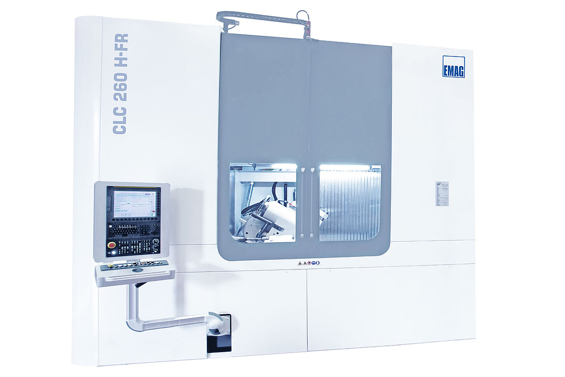

High-performance milling head
- Made of cast iron for optimum vibration damping
- Compatible with solid carbide disc cutters and carbide insert cutters
- Belt drive for high torque on the milling spindle
- HSK interface for fast tool changes
- Compact design enables large swivel angles
Versatile application possibilities
- Suitable for small series and batch production
- Optional: steady rests support for longer components
- Reinforced version (CLC 260 HW) available for more demanding tasks
- Machining options: Oil, emulsion or dry machining
Automation options
- Gantry automation or robot loading
- Feed and discharge belts for continuous material flow
- Stacking cell system for high storage capacity and organized workpiece storage
- Robot cells with stacking magazine for disc-shaped workpieces and long shafts
优势 CLC 260 H-FR
- High accuracy due to stable machine concept
- Heavy and rigid machine
- Steady rests on NC slides
- Deburring the screw outlet with a disk cutter
- Flexibility in production: from individual items to series production
- Efficient machining processes thanks to powerful milling heads
- Reduced non-productive times thanks to innovative automation solutions
- Versatile application options for different workpiece sizes and shapes
