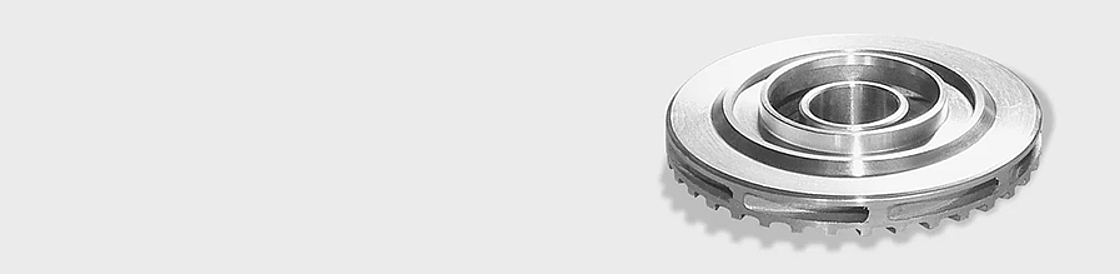

The differential pinions are part of the bevel gear differential. These components place special demands on manufacturing processes because the teeth of the pinions are inclined toward the center (like a cone). Differential pinions are manufactured on VL series machines in two clamping operations. The machines used are either VL 2 or VL 4 turning centers, depending on the diameter of the part.

Manufacture of differential pinions in two operations
  • The front end, the roundings, and the inside are machined in OP 10.
  • In OP 20, the teeth are cut and the outside diameter is turned.
